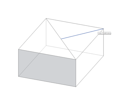

I am trying to understand if after I made a Form and I want to split one of the faces to two faces and pull one like in sketchup if its possible in revit?

you can see that I added a line that i want to split the face with him but the face is still one and not two.
in Sketchup when you draw a line its split automaticlly the face to two fxhu_0-1656013943891.png

TAB-Select the Line itself - not the Face.  Once the Line is selected, you'll be able to drag it out.

After add edge you can stretch it like this.
or like this:

I think what you are missing is knowledge about TAB-Select.  There are two surfaces between that Edge Line.
Functions of the Revit TAB Key | Ideate Inc
...or maybe you are asking about how to divide that surface horizontally?  Lock Profile and Add Profile will get you there.
