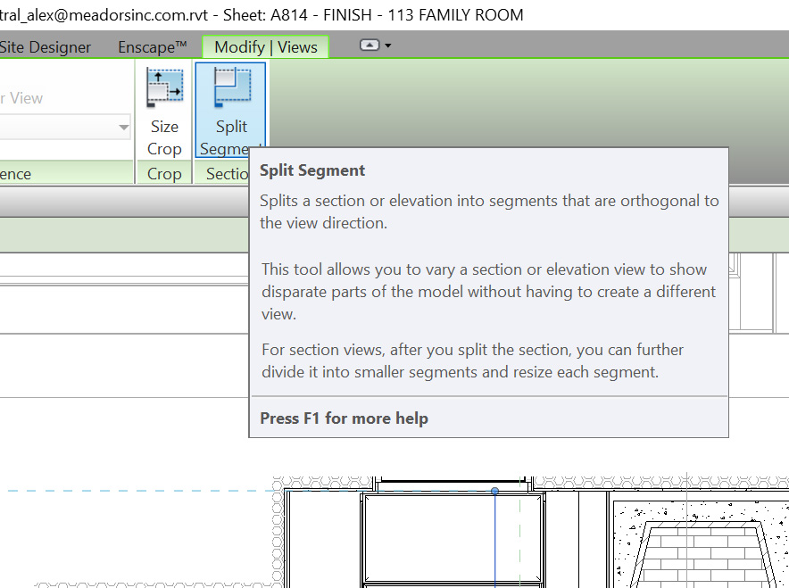

I'm using the Elevation tool to create interior elevations of all walls in a room. There is crown molding in this room that is created using the Wall Sweep tool.
The crop region boundaries for the interior elevation are locked to the wall finish on the left and right of the elevation, the floor below, and the ceiling above.
The crown molding shows just fine if the elevation is not split.  But as soon as I split the elevation, the crown molding disappears.  The only way to make it reappear again is to edit the elevation's crop region boundary so that it overlaps the walls on the left and the right.  I don't want to see the section of those walls.
Why do the rules that dictate what Revit sees in elevation seem to change when the elevation gets split?  Even if the crop region only showed a portion of the elevation, it should still show the wall sweep on the wall!

He's talking about something different than dividing the view in the elevation (also called "Splitting" as silly as that is). If you grab the view in plan and use the Split Segment button and then use that it seems to break the sweeps visibility. Revit 2017 (SP2)
Message 8 of 13
AlexLibengood
ToanDN, it's not an issue with splitting the elevation view in elevation.  The issue is with using the "Split Segment" tool that splits the view depth of the elevation in plan (see attached).

Okay, i think there is a fix. As said above in the first reply if you bring out the edges of the elevations crop box so the whole wall and floor and maybe the roof show up the sweep will show back up. From that point you can back the view back tighter towards the inner walls. Just don't take it all the way in. You can't seem to take it all the way to the interior wall face but at least it somewhat shows how you'd expect it to.

I just gave this a try again with the 2017.1 update and it still happens so it looks like that's a negative. It's easy to fix though as shown in the video you linked. Just walk the crop box a little bit out from the wall face.
