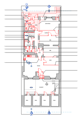

I'm running into this problem where if I want to use both split section segments and segment gaps I can't.
I working on this building, and I need to do a long section, but I need to split the segment in order to show what I want. I also want the segments to have gaps, so the line doesn't interfere with the other information on the plan. But when I try to add segment gaps to the section, Revit does this:
The long segments end up with only one control (or maybe they're overlayed?), and the only segment that actually has a gap is the middle one.
I tried doing new sections but I can split them and then add the segment gaps with no problem, and also noticed that depending on where down the line I make the split I end up with one or two segment gaps, but never all three.
Does anyone know how to solve this? Deleting the section and doing it again is out of the question.

I had the same issue forming slip segments with gaps, (Revit 2021). I found that the issue was that one of the section markers was outside the crop boundary so when the crop region was turned on it displayed only one grip on the segment whose marker was outside the crop region.
To resolve I changed the crop region to bring the marker inside it and masked out the unwanted geometry with a region
It must be a bug, dunno how to report though
