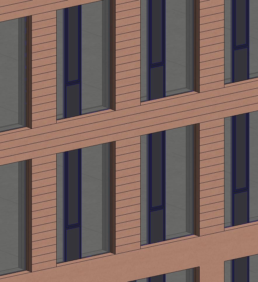

I need to split face horizontally and vertically in the same time, to have tiles.
Split face allows me only one direction / not intersecting.
Any help?

Tiles to the surface does not work, because the divisions are not supposed to be all same.
Curtain wall doesnt work too - i have a structure wall with 4 layers. A i want to split face of the exterior one.
The goal is to divide the face of the facade to various tiles.

rectangular tiles.

I'm not sure why a tiled finish won't work from your image.
However, you can split the face of a wall into tiles.  You just need to create them individually.  This seems like a lot of work, so we need to investigate if there are easier solutions.Split face.JPG

Split face tool allows you to sketch a shape on the face. it follows the same rules as sketching in Revit. YOu can darw the sketch in any direction.
http://help.autodesk.com/view/RVT/2021/ENU/?guid=GUID-C968BF26-C425-4DAE-A93E-CEDA2C1224B7
This example in the video shows sketching squares (edges are horizontal and vertical) on a wall.
