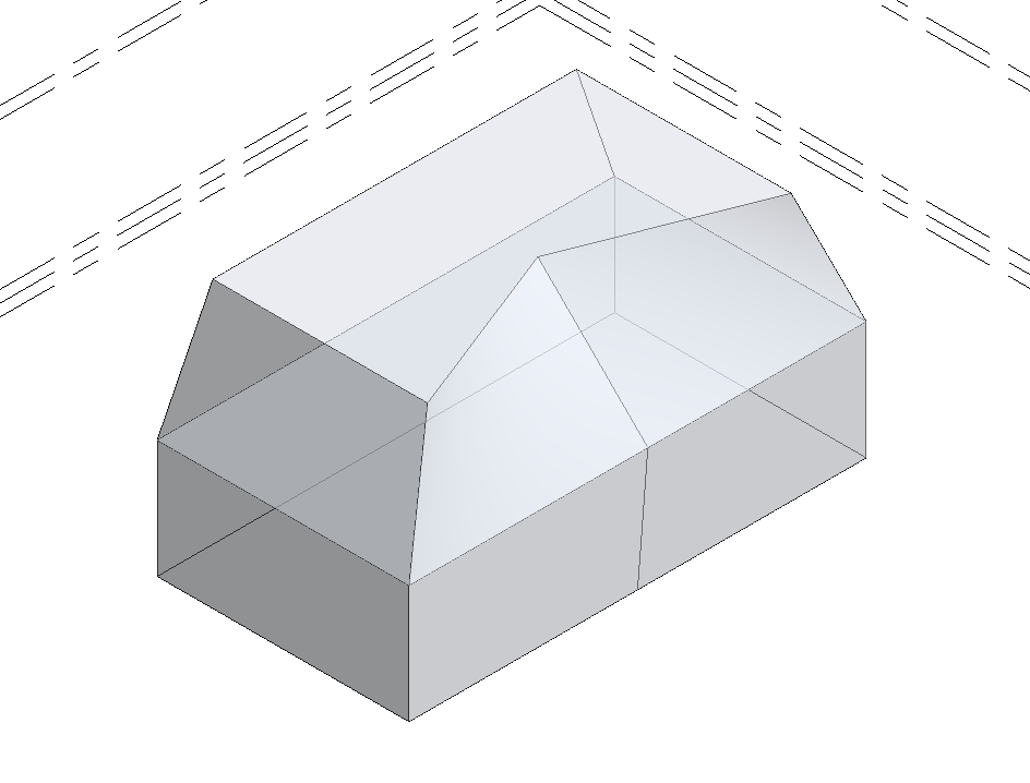

I created a conceptual mass using in-place mass as below first image. I would like to split a line to create an angle as the second image, how can I do that? Thnak you.
Current:
After:

it depends on how it is build your Mass..
Knowing nothing about how it was done, I think that you could use something as shown in my screencast.
Essentially you  have to place an extra point on that face...(Profiles and Edges can also be used but it depends much on the way you built the Mass)....
