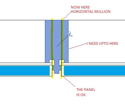

Thanks for giving a delightful suggestion, i follow the all procedure as you told, now for vertical mullion the problem is solved but the other problem generate that the size of horizontal mullion increase to same as panel size, actually size of horizontal mullion in between two vertical mullions, i attd the screenshot, give me a suggestion for this also.

Thanks for very helpful replies but you use rectangular mullion section but i am using Profile Mullion in which panel size bigger than Horizontal Mullion, see in attd screenshot. hope u understand my problem.

If you are using a specific profile for the mullion, go to Families - Profiles in Project Browser and either edit the type properties of your mullion and adjust the parameters so they fit with the panel or if you don't have parameters edit the profile family.
