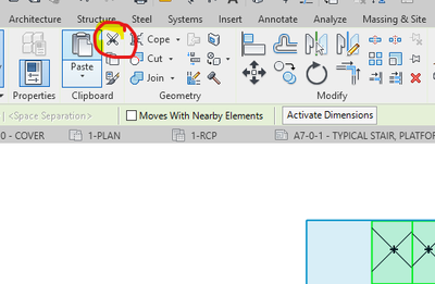

Nachricht 11 von 16
als Antwort auf: sandeep.gill28G3N5
See button below.  When you cut the lines, Revit will ask you if you want to delete the spaces, answer NO, do not delete them.
