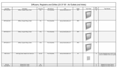

For many families I show an image of the product in the schedule. All is fine in Revit. BUT on PDF, some images show, some don't. Initially I thought it is related to file type (png etc.). but some PNG work, some don't.

Here the schedule in Revit:
and here on PDF (highlighted missing images). The 4 top types are the very same family and the very same image file (jpg in this case)
is there some setting or something else that causes this? This happens with a variety of families and seems random. The images come from manufacturer websites or screenshotted from data sheets. But all work in Revit...

I had " ignored" this issue for a few days since today I got an all new PC and also switched from W10 to W11. I was hoping a complete new install, hardware and different OS may fix some underlaying issues. Originally I didn't realize the R2025 file I downloaded today (!) didn't include the SP updates. That still had the same issue. Then I applied the updates (R2025.4.2) to no avail - still the same problem.
Ugggghhh
But then I installed R2026.1 and it works! This is from the very same project file (just upgraded to R2026) on PDF. Basically looks like in Revit. WYSIWYG.
Now I'm in a conundrum. I kind of have control over my Revit version and can use R2026. But I didn't really want to upgrade before the end of the year (to avoid any schema issues etc.) . On the other hand, R2026 clearly fixes a big issue for me. And unless I want to give up images in schedules, or spend days in a rabbit hole to get it to work (if even possible) in R2025, I kind of have to move up to R2026.
