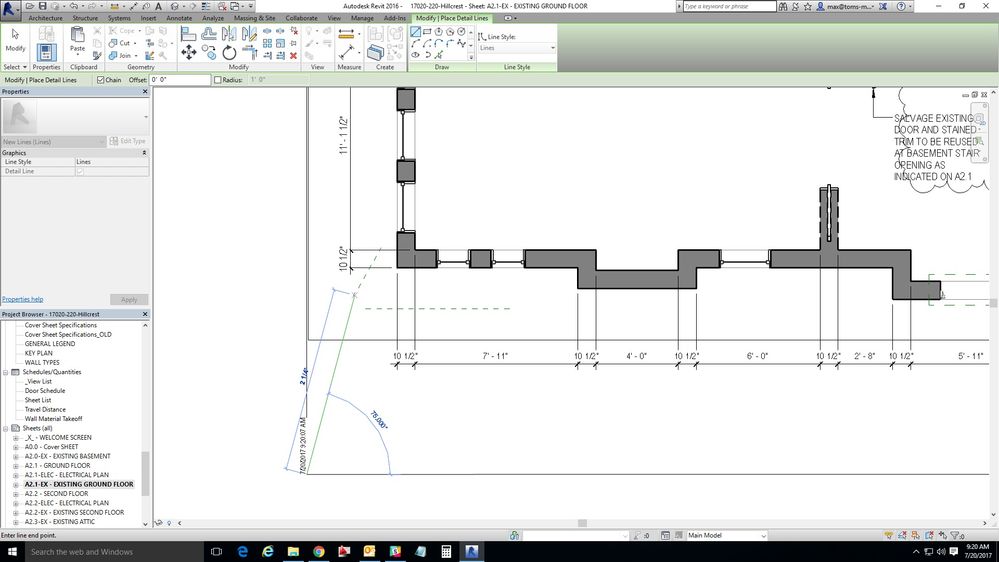

A few days ago I used this YouTube tutorial to set up my plans in an aligned position on my sheets. I believe at the time I was able to make my detail line in the sheet snap to the corner of my reference plane in the viewport. However I'm trying to do it again and I can't seem to snap to anything in the viewport without activating it, at which point I then can't snap to anything on the sheet. I'm not aware of having changed any settings but I can't explain why this worked a couple of day ago but doesn't now.

I created a Reference Plane in the model so that I have a common point visible on all plan sheets. I am then trying to draw a Detail Line on my Ground Floor Plan which I want to snap to one end of the Reference Plane line. The idea is to then paste in place through on all of my plan sheets and move the viewport on each sheet using the corner of the Reference Plane (just as is done in the tutorial). It seemed to work fine when I tried it before but now in sheet view I can't get my Detail Line to snap to the end of the Reference Plane line. Is there a setting that toggles this on and off?

Thanks. Still not working. I've taken a couple of screen grabs for reference:
- The first one shows my viewport on and I am able to get a detail line to snap to the vertex of the reference planes.
- The second one shows my viewport off but you can see that snaps are still on as I am able to snap to the corner of my sheet outline
- The third one shows my view off and I have started a detail line but I can't snap to the vertex of the reference planes

I reviewed the YouTube video as well and found the issue. The Detail Line will only snap if the Reference Plane is drawn on a horizontal axis, not a diagonal one (pictures attached). I can't fathom why this would be the case, but in any event I now know the issue and will be able to avoid it in the future!
Thanks for everyone's help! It's always easier to solve a problem when you have people trying to help you through it!diagonal line no snap.jpghorizontal line snap.jpg
