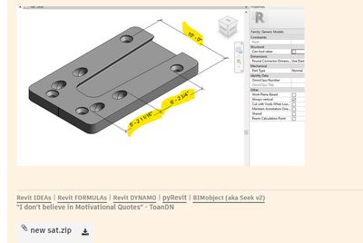

RDAOU
als Antwort auf: ToanDN
Hard to miss this one...did you not notice something a little bit off when you placed those dimensions?
