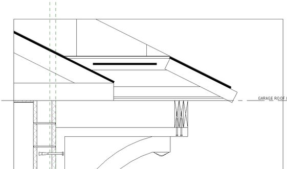

Is it possible to align or snap to a sloped surface that has been cut by a section plane?  IE, I have a section through a roof slope and would like to add 2D detail elements to the section cut.  However, I cannot align my 2D element to the cut through the sloped portion.  Please see below for reference.

Try adding a Reference Plane in the section, then align 2D elements to it.

I can draw a reference plane, but still cannot align it with the sliced edges of the roof plane.  Revit seems to ignore those edges?

In the video, I am in a section view.  The section cuts through a sloping roof plane.  I would like to align detail elements where the sloping roof plane is cut.  However, I cannot align to the edges where the section cuts through the roof plane.  You can see elements that are available to for aligning to, but when I move over the roof plane elements, they do not highlight and are not available for alignment.
Negative on the workplane question.  This is a simple section cut through a roof.

Okay, so I looked at your video. I see the component (plywood) and I see the roof and I see the Ref. Plane.  What I don't understand is the reason for the Ref. Plane in the view. I thought you wanted to align the component to the roof.  Am I misunderstanding?

You normally cannot but there is a workaround using Parts.  Unfortunately not everything can be converted to Parts so often you still need to draft ref planes or other drafting elements over and just eyeball them to match the model.
In reality, I have never found myself needing to dimension something like that.  I dimension where the builders can build, not where they look pretty  on the drawings.
See screencast for the workaround I mentioned.
https://knowledge.autodesk.com/community/screencast/656d5d79-e816-41a8-9aa9-8fa3437a2a57

I added the dimension to demonstrate the ability to snap to the geometry.  Without splitting it to Parts it can't be done.

The ref plane was in response to @cbcarch suggestion.  I was demonstrating that it did not work.
@ToanDN It isn't something that I need to dimension to, but I do prefer accuracy to eyeballing.  I am a little OCD about.
So the consensus is that Revit ignores cuts through sloped roof assembly surfaces and, to place the detail family, I need to eyeball it.

You could export the section view to DWG and link it back in the same view, turn off layers you don't need, and snap dimension to the CAD linework.

When starting a detail line on the edge of a solid all the points are designated as NEAREST to [ ]. When placing an adaptive family all of a sudden the point where  the edge intersects the (section) screen, becomes a "special" point ENDPOINT of [].
Using a helper family (adaptive generic model, containing only 1 adaptive point) you can mark the point where edges intersect the screen plane, and use those points to draw the line(s) you are after.

@chughes No, that is not correct.  Detail components do align to the sloped edge of the roof in a section view. There has to be another issue causing this in your project, or in that detail component that you are using. It is difficult to determine that by just watching the video.

That's what I thought @chughes was talking about, but I think what he's talking about aligning a detail item component to the non-sloped (horizontal) line work of the hip roof in the view. Either that, or we're talking about pots and pans. I dunno.

Heck yah, @ToanDN! Works like a charm! Better than a gnat's eyebrow. Smiley Wink

Well, what I said above works if the section is perpendicular to the direction of the slope. I see that if the section is at a weird angle, then I see that it's not possible to align and snap to the line of the roof.
