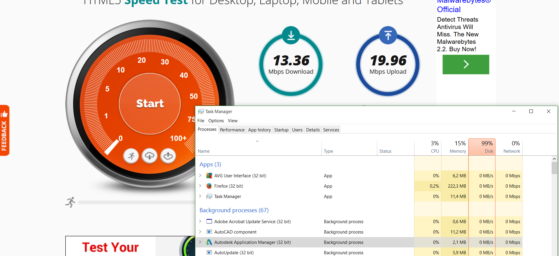

Message 7 of 10
Hey,
Thanks for your reaction first.
On the image can you see the processes that are running. There is a process called: autodesk applocation manager. Do you mean this program?
If yes, is there a way to prevent this process from starting when the computer starts? because when I end the task, it will be reactivated when I start my laptop again.
I have the application manager disabled in the startup list so it should not startup.
I look forward for your reply.
Message 8 of 10
@vvanduijnhoven, Good job!  The solution is perfet. And ...
What I wonder is that why "autodesk applocation manager" casue wifi scan so frequently, when i used omnipeek to capture the wireless packet, I found the laptop sended 802.11 probe packets every 6 senconds when "autodesk applocation manager" process was running. And when I killed it, frequently scan disappeared . Could you please ask some teachers or some Revit software engineers for more information about this phenomenon?  thank you very much. I was so curiosity about it and look forward to learn more
Message 9 of 10
Thank you so much for your reply.
I now disabled "autodesk application manager" in the startup list aswell in the services list so it won't startup anymore when I start windows.
The download speed is now by default around the 20Mbps so that is lots faster as the 8Mbps.
I have vacation at the moment so I am not at school but when I am at school I will ask the teacher if they know why the application manager is scanning so frequent. I will also tell them the solution because I was the first one who asked them for this problem so they want to know the solution to.
Again, thank you so much for helping and I will reply you when I asked the teachers.
