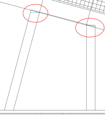

@barthbradleyI've managed to get the walls as you suggested using the mass and the wall by face tool but I'm left with the following where the walls don't meet the roof:
Now, normally I'd use the attach top/base tool but this does not appear as an option for me; I suppose it is due to the way it was created.
Are there any tools which would fix this issue?

Join geometry the wall and the roof.

I would edit the Mass and make it taller (start it from top surface of Roof), Update to Face the Walls, and then In-Place Model a Void Extrusion to cut all the Walls flush to the bottom surface of the Roof.

@ToanDNI tried your suggestion to Join geometry but nothing happened - the walls remained in the same place so was left with trying barthbradley's suggestion...
@barthbradleyI was really struggling with editing the mass as it didn't want to play nicely but eventually got there after starting again.  Once I put the walls on it, it came out like this:
with errors saying it couldn't keep the walls joined. What would you normally do here?
