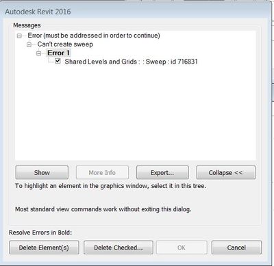

I've followed your instructions above and keep getting the can't create sweep message? See screenshots below.

Nevermind figured out the problem.
