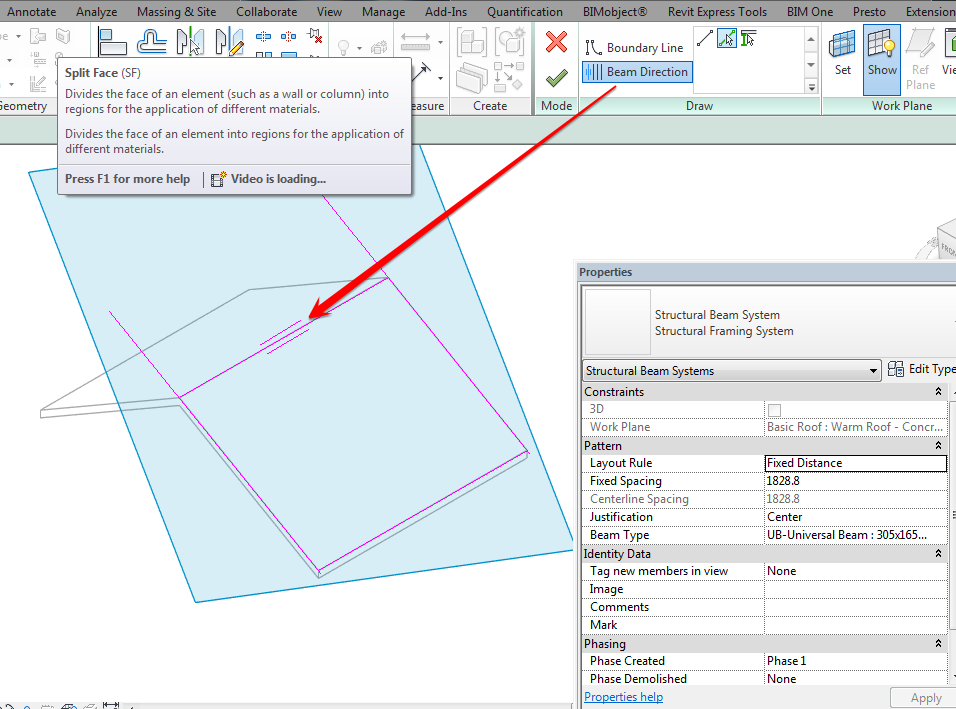

We have a building structure that is 100' wide with a 1/8" / 12" slope roof. I created the roof slab system and now would like to add the steel roof framing system. How can I add the roof joists to be sloped? I can get it to be flat.

try these steps:
  • Structure >Beam System > Work Plane > Set > Pick a plane - pick on a roof face
  • Boundary Lines > Pick Lines - tomake a closed polygon
  • set Beam direction
  • Use Modify > Trim/Extend to Corner in order to obtain the closed polygon
  • Now the system is made - Fix the Layout Rule - you have the following options: Fixed Distance, Fixed Number, Maximum Spacing, Clear Spacing
  • in order to move up/down the system ( for instance under the roof surface) click on the small parallelogram  to Dissociate Work Plane
