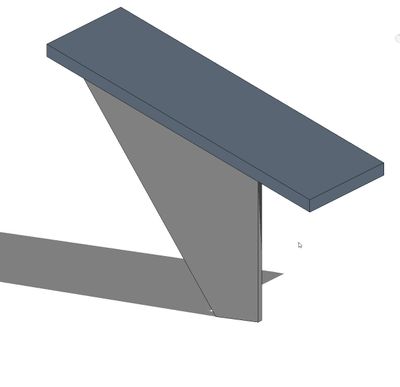

See the slanted wall below:
Now view it from an angle:
I need to edit the profile of this wall so that it has a similar angle as the columns you see next to it. I need it to be like this when viewing it from the side elevation:
However, when adding a slant to a wall with an edited profile I am getting the following message that does not allow me to do this:
I am using Revit LT.

I've never encountered that error.  The Profile is doable though. Do you have all four sketch lines?

@barthbradley Just verifying, once you edit the wall profile, are you able to add a slant to it?

Yah...and attach it to a roof afterwards via the Attach Top/Base tool.

here's the Profile for that wall:

Ah! 2021 Slanted Wall!  I see now what you are trying to do? I can't do it either.
What about Cutting the Angle with an In-Place Void?

I don't believe in-place void is available in Revit LT.

Model the Void in a Family then.  Check "Cuts With Void When Loaded".
