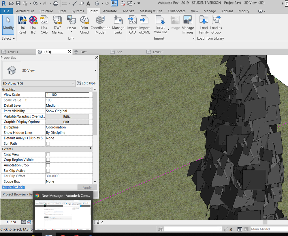

This tree I downloaded from 3dwarehouse is the only Polyalthia Tree 3d model I could find. Apparently there is a png image used for the leaves,  the png is the tree's leaf without background.
The image below shows the tree on sketchup:
Now in the image below you can notice that the image is like an png image with no backgroud, when selected the object is a rectangular plane:
When I import it to revit I get only the plane, without the "png " image of the leaf
How can i make those leaves to appear on revit? or how can I turn this tree into a green one?

Is the PNG assigned to the Material that the Sketchup is using (Object Styles=>Imported Objects)?
Nachricht 3 von 3
als Antwort auf: Caed9
You would have to recreate a material using the leaf image AND another Cut-out image to make the part outside the leaves transparent.  Just use an RPC tree come with Revit instead.
