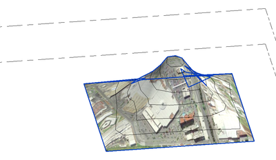

I have created a topography and I keep trying to put an aerial view image of the site from google earth as  the material.  But whatever image i place on the site become inverted or mirrored when on the texture.
jasonmazis_0-1654712893320.pngbelow is the image
 Any help is appreciated as this fairly urgent.
Thank you

How are you applying the Material?  That is, what element is using it?

what happens when you rotate the material?

It flips in other directions  no matter which way i rotate it it will not match the original

topography- | first duplicated the site material which was grass and changed it. ten I made a new material

Are you sure it's being inverted and not just oriented to True North?

It comes in as an exact mirror
Nachricht 12 von 16
als Antwort auf: jasonmazis
Mirrored or inverted?  Two different things.
Just post your two files as I suggested above.  Otherwise, it's just a guessing game.

I think this happens because the topography is an irregular shape
try to edit that topo surface to make it rectangular.
then te scale have to be the same, this is only an example

As a test, apply the same material on a floor and see if it comes out correct.

Try rotating the image slightly 0.1 degree.

Hi with a whole host of rotating and a mirror of the image in Photoshop I seem to have got the correct angle no I am just trying to resize it accurately thank you for your help.
