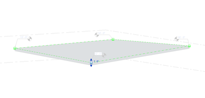

Hello there. Does anybody know how to make a sloped roof but with different dimensions in each wall?
My screenshot will help.
Also I want the wall in the middle to be attached on the roof on the same direction. The shape of the roof is the result of the wall heights. Thank you in advance!

Full Revit? If so, use Modify Sub-Element Tools to shape edit a flat roof.

You can absolutely make a single sloped roof (single plane) from 3 points. The fourth point should be given based on where it projected on the roof. If you rely on four points that are not calculated correctly, the roof will be warped.

You can also try the Slope Arrow in roof.

Hi!  Yes the whole project is in Revit if I understood your question! I managed to do it with what you suggested Modify-Sub Elements Tool! Everything looks fine. With this solution you cannot use the Divide Parts Tool in case you want. Thank you very much for your time and help!
