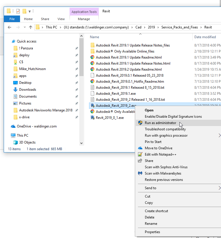

I had another user install 2019.2, but when he looked for Revit 2019 it was not there.
See the proof in the screen shot below. Revit 2019 is not there... (View installed updates doesn't show the update either)

You telling me the picture in this case is not worth a thousand words?
No!  It is not possible!  I typically never add updates to a deployment even after the fact.
Revit 2019.2 update is clearly installing 'successfully' without Revit 2019 being installed.
Now the two computers that this happened to thus far do have Revit 2018 installed. One had Revit 2017 installed also.

The picture doesn't say anything about the deployment image used to install the software :leicht_lächelndes_Gesicht:
Your text reply does though. What is the file (and size) of the update your user is accessing to do the installation?

Autodesk_Revit_2019_2.exe    681,212 KB

I understood what you wrote earlier to mean a user installed 2019.2 without having 2019 installed first. Is that correct? If so, what did they use to install 2019.2? Edit: I didn't see the image with files until I replied.
Edit again: I've read through again a couple times. It sounds like the 2019.2 update is "installing" but not detecting that 2019 isn't there to update. If so, that's not how we'd expect it to work. It ought to declare 2019 not found. Since it is "installing" but not really, when you install 2019 it becomes "necessary" to uninstall the update so it can install again "properly".

"...a user installed 2019.2 without having 2019 installed first?  . Is that correct? "
Yes, that is exactly what I mean.
"If so... what did they use to install 2019.2  ?"
Rather old fashioned, right-click on the executable selecting Run as administrator.
