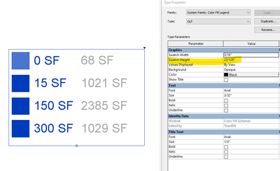

I'm using your workaround 1 to great success - I have a color fill legend reading out the area names with a separate schedule reading out the areas. Each row in the legend is corresponding to each row in the schedule well.
However, I can't seem to do the "fine tuning" you talked about to make the rows from each line up - I have the rows in the legend to show the smallest swatch size possible, but there is still more space between each row in the legend than there is in the schedule. In the schedule, I have the body text set to the same size as the text in the legend, but the rows are closer together.
I can't seem to increase the line spacing of the area names in the color fill legend, or decrease the spacing of the areas in the area schedule. Have you ever made this work? Thank you in advance.

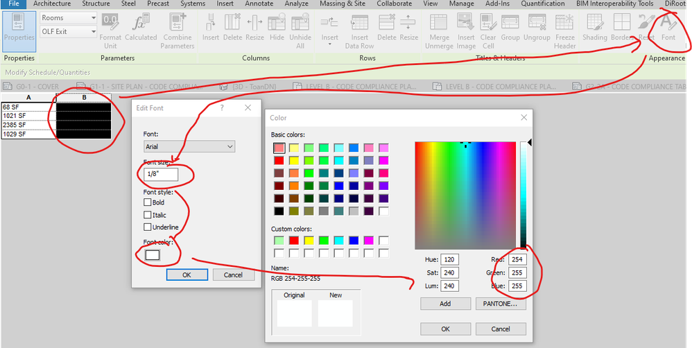

Here is an example of finetuning them.
If you legend line spacing is already at their minimum then you need increase the schedule row spacing by adding a column to the schedule, override the column to a bigger font size and white (254 255 255) color.
You can keep changing the font size until the schedule matches the legend, or adjust the legend swatch height until the legend matched the scehdule.
Nachricht 14 von 14
zacharytbroussard
als Antwort auf: ToanDN
that works - thanks!
