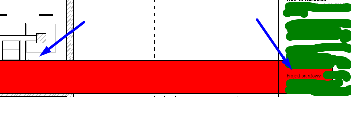

Is there a way to set the sheet background color to not be white? I tried to edit the family and add the solid filled region - it works for the titleblock but the drawings that are placed on the sheet are covered by it. I know that there is a way to work around Revit not allowing to place regions on sheets (not in the family), but I would like to not have to repeat the process manualy since there's going to be a lot of sheets in the project.

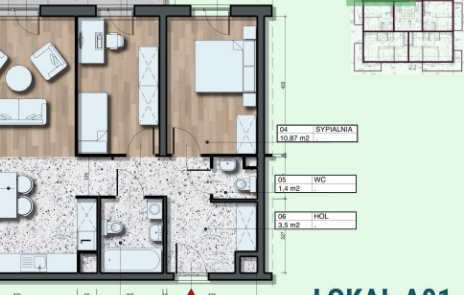

TO CLARIFY: I want to change the sheet, so when I print the documentation the paper color is not white, but in color - for example in green like shown in the attachment. So it's not the workspace I want to change, but the 'paper' color of documentation.

Thank you for taking the time to reply. I guess I structured the question the wrong way 😉 I want to change the sheet, so when I print the documentation the paper color is not white, but in color - for example in green like shown in the attachment. So it's not the workspace I want to change, but the 'paper' color for documentation.
