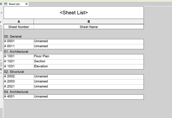

How can I create a table like the submitted form so that it separates different drawings, for example, separate structural drawings and separate architectural drawings?

Add an instance project parameter to Sheets category (Drawing Discipline) then Sort and group Sheets and Schedule/sheet list using that parameter

Sorry I had another question. How can I arrange the table to my liking? For example, first be public, then architecture, then structure, and so on

The sorting works alphanumerically ...
Either add the order sequence to the initial sorting parameter you used above ... something like 00.Gerneral 01.Architectural 02.Structural

Hi RDAOU. Hello. Why is the order of the architectural part disturbed?

Go to Sorting and Grouping and from the drop down menu of the  third criteria ... Select "Sheet Number"
Now you should have
  1. Sheet Discipline (Hidden - Shown in Header)
  2. Discipline Grouping (Hidden)
  3. Sheet Number
