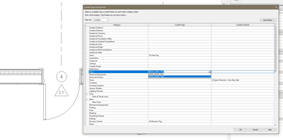

I followed a couple of different tutorials which gave me the same approach to creating a custom tag. I loaded up Revits' "Generic Tag" family and quickly added the Shared Parameter label as show below- note the "Structural Framing" Field dropdown:
Before saving and uploading the Family back into my host file, I ensured that the Family Category and Parameters were set correctly (I believe). I ensured that "Structural Framing Tags" were selected so that I could slot my tag into Revits' master "Loaded Tag & Symbols" dialog:
After doing this, I re-assigned my new tag in Revits' Tag Loader as shown below:
After ensuring everything was lined up, I used the "Tag All Not Tagged" dialog, which is usually brilliant but after running it, nothing appeared:

Did you actually build a Lintel "Structural Framing" Family, make it Shared and nest it into the Door Family?  In other words, is there any Structural Framing there for the tag to tag?

If there is not Structural Family in the Door Family - as a Shared Family -then there is nothing to Tag.  Right now, all you've done is add more data to your Door Properties. If you want a Door Tag to read/report this data, then you need to pull the data into the Tag Family Label.  To do that, the Parameter needs to be a Shared Parameter and that Parameter is the one used for both the Tag Label and the Project Parameter that is assigned to the Door Category.

So, I've fiddled with the settings of the tag, itself. I adjusted the Category Parameters- deriving the "Lintel" string as such:
I suppose because you can only pull from one type of category at a time (ie: Doors, Windows, Openings, etc.) I'll essentially need LintelDoor, LintelWindow, LintelOpenings, etc. ?
The other interesting thing to note is that because I'm pulling the Parameter from "Doors" now, that the Tag by Category dialog only permits one type of tag at any given time. I would have to manually select which applicable tag I want to use to do the tagging in two steps:
But if it works, it works! The above isn't really a deal-breaker since I'll be tagging lintels on a separate sheet, anyways! I suppose there's no way around this without modelling something into each family under the correct category? I think this accidental discovery might just be the fastest / easiest way to go ahead, if you agree? :leicht_lächelndes_Gesicht:

If you want to use a Structural Framing Tag then you need:
- a shared structural framing, it can be without any geometry, just a linework or symbol should do
- nest it in the door family
- associate parameter of the nested family with the door family so you can change it directly in the project
- when tag in the project, use TAB to pick the lintel
Another way is simply change the Structural framing tag to a Door tag and use it to tag the door in the project where you need to show the lintel tags.

@ToanDN , I really like your idea of nesting a "hidden" line into whichever families needed. Pardon the newbie question, but how would one go about creating a model line, or extrusion under a different category in the same model- would you need to import a model line, or extrusion under the "Structural framing" type? (This could be handy if I'm cutting sections as opposed to having to fake it later).
As for the latter, I found that this might be the lesser of the two evils- at least for now. It would admittedly be a pain if I needed to tag a lot of doors on the same floor plan, but since I'm splitting my architecture from structural placeholder drawings, I can always swap my "door tags" from the Loaded Tags and Symbols menu:
