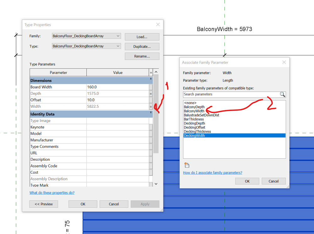

Hi All,
Any assistance appreciated!
Please see attached Revit 2019.2.2 file.
I have a complex family for a pre-fab balcony... It contains nested shared families so I can tag them.
The nested shared families have instance parameters so I can use them in formulas in my array.

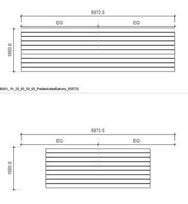

When I load the host family in, I am getting unexpected behaviour...
I have stripped the host family down to just the decking to illustrate the problem...
Both family types in the illustration below have been told to be the same width, but the lower one isn't responding correctly:
Incidentally, I have made the balcony a 'column' family category so that it will be room bounding.
As I understand it, my families are all built in a robust manner, I would appreciate any thoughts or comments which might help.
Mark
14 ANTWORTEN 14
Nachricht 2 von 15
MostafaElashmawy
als Antwort auf: Mark.Ackerley
You was connecting the width of the nested family to a parameter called Decking Width while it should be connected to the parameter called BalconyAnnotation 2020-01-10 132937.png width.
Check below and attached.

Thanks for the response...
You are correct that reasigning the parameter to a new value does 'reset' the values... Thank you I will use this for now, but I would also like to understand why that parameter broke...
The parameter Decking Width is related by a formula to Balcony Width...
This is because the Decking Width will be different to the Balcony Width.
Could you explain why you think using a different parameter would create the inconsistent behaviour seen in the image? Both of the types are linked to Decking Width of the same value, but the lower type is not responding to the value correctly...
Here is a gif which shows the inconsistant behaviour... You can see the lower Type does not respond to the change in parameter value...

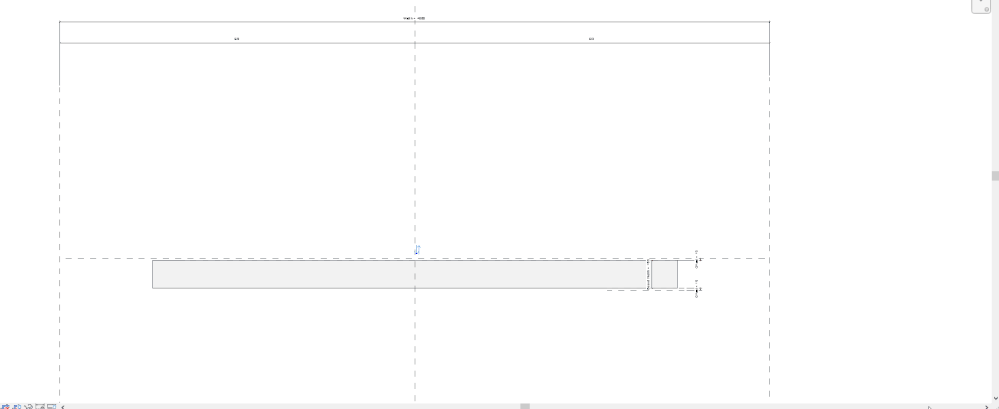

  • The seed family (single plank) is ok as is
  • the Balconyfloor_DeckingBoardArray
    • When you insert the plank...lock its width using the shape handles - drag and lock to the reference plane driven by the width parameter (do not use associated parameters)
    • additionally, the array is locked to the start plane but its end is floating. you need to add a ref plane and set the depth...then lock the end of the array to that plane
    • the 10mm offset between the planks if it is always 10 (set its value in the formula to grey the value out)
  • load into the balconytest family...lock to the center planes and associate parameters

Just noticed your gif...you do not have shape handles because you have associated the instance parameters of the plank to those in the Array family... unassociate the plank's depth and the width IP to see the handles
After you lock the handles ...lock the middle ref plane then then associate whichever parameters you still need

Nachricht 14 von 15
RDAOU
@Mark.Ackerley
It must be something not constrained properly. Here is the screencast for the full process. Sorry I didn't post it as I thought you have solved your issue and moved on.
