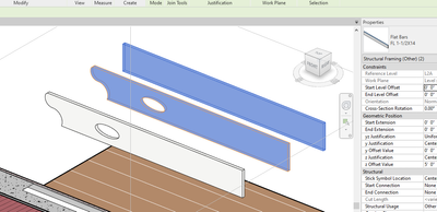

Hello all,
I have made a new family for my timber framing. But I have the problem now that my Shape Handle does not stretch the wooden frame.
Does anyone know how to fix this?
I've added the family in this message.
Thanks for the help in advance!

You have constrained the ends of the beam to the reference planes that are assigned for "stick symbol", which are the limits of the single line representation of the beam when the view is set to coarse. Edit the family so that the extrusion is limited by the other reference planes (higlighted in this image).

Thank you Alfredo,
Your explanation was clear and did the trick. Thank you very much.
