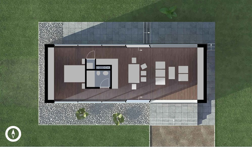

Ilic.Andrej
You cannot have a good impression from light that comes through windows if the whole shadow casting model is cut in half. Having shadows from the the whole building gives long and expressive "light beams". Even when looking at plan views, clients can feel where we put large glass surfaces.

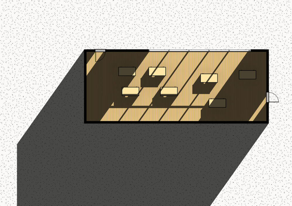

What part is photoshopped?
Below is the effect from overlaying two viewports.

Message 17 of 22
A 3d top view with no roof and a floor plan, same scale.  Place them on sheet in that order.
The floor plan is only needed if you want to show things like door swings, windows being cut, and dimensions.
