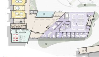

Hi
I have noticed an is with shadows in a view.
The shadows properties are assigned to the view and are transparent,
but when the view is dropped onto a sheet the shadows are opaque.
How is this?

Apologies about the delay, I totally forgot about it. I wouldn't be in a position to share the model.
I am aware of controlling properties on a view-by-view basis, but this is the same view. The problem arises when the view is dropped onto the sheet... the shadow turns opaque.

Thanks again for your time on this.
Just so we are on the same page, I will outline the issue again. If you look closely at the two images in the OP, just above the number 28 at the bottom of the picture, you will see the difference in the shadows. In the actual view you can see the outline of the grass area, but when this same view is dropped onto the sheet, this shadow becomes opaque and you can not see the outline of the grass. The same view properties are assigned to both as it is the exact same view. Nothing should change.
I am thinking it may be a bug. I have yet to notice it on other projects, but I do not focus my attention on shadows myself. It was brought to my attention by a colleague for this particular model.
Do a quick test: ( 5 minutes or less.)
Create a new Project. Draw 2 walls, turn on shadows.
Create a Sheet. Drop the view on the sheet. How do shadows look? If they look correct, (transparent)
then that means something might be wrong in your posted project.

Good one @ToanDN
I was looking up similar rendering cases, so looks like this may be the cause the OP is experiencing!
See article: Revit - shadows in cropped floor plans and 3D views
@Kev_D lets us know if removing the crop region has any effect on the shadows' display!

Thanks to both of you for your help.
I reopened the project that I had the issue with and checked to see could your workaround fix it, but it seems that the issue does not exist anymore. The only thing I can think of is that recently, I upgraded the version of Revit I am using, so that may have fixed the bug.
