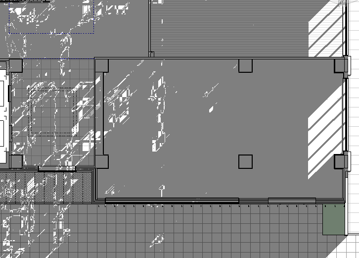

Hi all,
I am working on a rather large project (33 stories), This problem happen when I cast shadow in Revit (see image below), Many small points are missing shadow! I spent time to research but still don know how to fix this,
Do I missed some shadow setting or just b/c of my graphic card?

Message 2 of 12
ennujozlagam
hi, i have a feeling it could be your graphics card update the driver or go to options > graphics> untick "use hardware accelaration. hope it helps. thanks
Message 3 of 12
Thank you for your help, I have already tried it, unfortunately still can not solve this issue,
Message 4 of 12
ennujozlagam
hi can you check your "properties" underlay change to none or check your view range.
Message 5 of 12
Yes thank you, I set the underlays to None and already try all options of the the view range (adjust cut plan, bottom, view depth.. ground level, basement, unlimitted...) But still can not solve this,

Message 7 of 12
ysautodesklover
I have exactly same problems in multi-story building...
Only top floor doesn't have the problem and the shadows on the other floor seem like

Message 11 of 12
Just did an 2021 Upgrade to the file. Still the same. Here is a screenshot. unfortunately due to security reasons cant share the file but the problem is the same one as the previous posts here. 2020-10-01 09_49_05-Window.png

LukeLZ
Hey All,
I think I may have a solution. Within the Sun Settings, set the location of the site accurately.
Our original location was set to somewhere in Boston for some reason, this simple change fixed the issue instantly.
