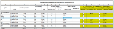

I was wondering if it is possible to set a yes/no parameter (used as a area parameter)
to a default setting when creating new area's.
We use it to define or certain values in a schedule show a parametric calculated or a manual given value.
Right now when adding a new area, the YES/NO parameters are not defined as YES or NO (greyed out),
i would like to have them as NO by default.
Thanks !

Unfortunately, there isn't a way to set the default state, as far as I know. You can read more about it on this thread: how to project parameters defaulted off - Autodesk Community - Revit Products
The only way you could achieve what you want would be to have a custom addin that listens for new area creation events and set the parameter value to No as soon as the new area is created.
It shouldn't be too complicated to code for a decent addin developer.

actually i tested with "-1"  and it works
import clr
clr.AddReference('RevitAPI')
from Autodesk.Revit.DB import ElementId
clr.AddReference('RevitServices')
from RevitServices.Persistence import DocumentManager
from RevitServices.Transactions import TransactionManager
doc = DocumentManager.Instance.CurrentDBDocument
def tolist(x):
	if hasattr(x,'__iter__'): return x
	else : return [x]
inv = ElementId.InvalidElementId
items = tolist(IN[0])
param = IN[1]
OUT = []
TransactionManager.Instance.EnsureInTransaction(doc)
for i in items:
	itm = None
	par = i.InternalElement.LookupParameter(param)
	if par is not None:
		try:
			par.Set(-1)
			itm = i
		except:
			import traceback
			OUT.append(traceback.format_exc())
	OUT.append(itm)
TransactionManager.Instance.TransactionTaskDone()
