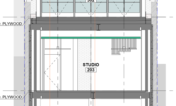

This is how you can segment a section. but it seems you only can adjust from where you see the section. So it adjsut what you include from where we see.
But what I want to do is adjust how far I can see. See below. The red should be how far I can see and the blue part should NOT be seen. in my example the blue area is a separate room and the section also shows things in that room, which it shouldn't. I tried to use an elevation, but that shows me the same.
Is there a way to do that? Google told me thee is a plugin, but i cannot install plugins (IT rule).  So i need to do it with what Revit gives me.
I want to avoid having to place 2 sections next to each other.
Revit version: R2025.4

To clarify my example: the room has a staircase on top left and similar to my original sketch the red line i drew marks "how far" I want to see. The blue box is the staircase. The problem I have is, that the view that is supposed to show what is in front of the wall, also shows items in the staircase (like light fixtures).   So what I really want is a section or elevation to behave more like a camera view (not use X-ray to look through walls).
Hope this makes it more clear. I don't want to add 3D elements and then hide them. This would create much work and unintended things in other views (M, E, A etc.). i also don't want to manually hide elements since that laos adds work, and doesn't update if I add more elements during design.
But I found one possible solution. I originally had the section view as "Mechanical" and there it shows what is "behind" the wall separating the space and staircase. After changing it to "Coordination" (no other change!) it works like a regular camera view and does NOT see through walls. I'm sure this will have other unintended consequences. I wonder if "Mechanical" can be made to behave like that?
This isn't the first time I need to resort to "Coordination" to not show items that should not be shown.
Edit: I'm marking this as resolved since changing to "Coordination" seems to accomplish what I want. I still think A-desk should give us a view adjustment option to do that in "Electrical".
