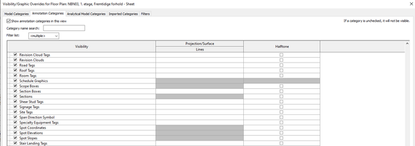

So i placed 3 sections on my first floor. Then when i go to my second floor, (Which has the exact same settings as my first floorplan) i cannot find the sections i'ved just created.
They are cutting through the whole building.
They are not hidding/Isolated.
The hide coarser than is set to 1:100 my plan is 1:100, ive tried multiply settings for this one, still not working.
in the VG they are set ON!

Maybe in another Phase? Maybe View Range doesn't intersect them? Maybe....

Your floor plans do not have the same settings, one is Medium and the other is Fine  (not to say Detail levels affect the display of section).  Create a view template from the 1st floor and assign it to the 2nd floor see if it helps.

I think your sections hide at scales coarser than 1:100
If your flor plan is 1:200 o more than 1:100 It will be hide fot that configuration

So ya, i've gotten a new sheetlist with updates, and just renamed one of the drawings, and didn't change the phase.... so ya
Nachricht 6 von 6
als Antwort auf: s192019WWFUF
So, I guessed right! It was phase related!
