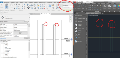

Hi! How did you choose this option?
In section view I can't select the type of line.
FmyTtG3
Also I've tried to find the invisible line type in my revit version ... But I can't find it.
q5JWsqp
Can you help me to select the invisible type line in projection lines?
Thank you all!

RDAOU
@Anonymous
You are in the wrong menu tab...Go to the Modify Tab
  1. First delete all the lines you already placed
  2. Exit all commands
  3. Type LW on your keyboard or go to Menu Tab > > Modify >> Linework...That is different than Symbolic lines

set Far Clip to 0.1 mm (1/256") and then turn Thin Line OFF in Revit and DWDISPLAY ON in AutoCAD.  Bet you don't even see it at normal scale and zoom.
Message 11 of 13
martijn_pater
hmmm by the way, if the goal is only getting these section lines into autocad, couldn't you just color your cutlines with visibility graphics (VG) and then select/filter for those lines in autocad and copy them or delete all the other lines?
Message 12 of 13
I'm not sure I understand your point, @martijn_pater . My point was that a workaround may be unneccessary.  IME, with Far Clip reduced to a minimum, that linework isn't even detectible when the Revit/AutoCAD view at normal size, scale and pen weight.
