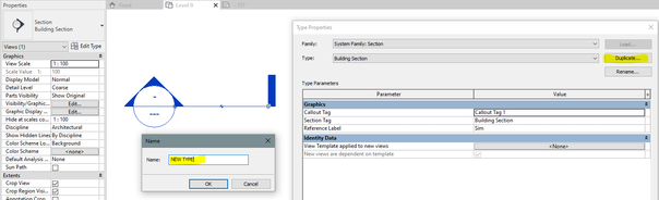

Default Section
Duplicate that type and give it a new name
With the new type select the section tag
When selected also duplciate this Section Tag
Give it a new name and select other section head and section tail
The End Result
