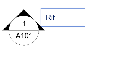

How to make a smaller section symbol?
I modified the family with a smaller circle and smaller text so it don´t occupy a large space in my drawing but it doesn´t seems to work, even when I load my new family. how can I  tell? I change the letter type og the tag but still using the "default" family.duda.png
3,461 Views
You want section symbol to occupy less space right?
For this you just have to edit type the section symbol and set section tag.
In section tag just set section head and section tail to none and manually add text such as A-A or X-X.Annotation 2019-11-08 212859.jpgAnnotation 2019-11-08 212930.jpg
freeriderfx
I was loading and changing "call" not section. My Bad!!!!
Thanks so much for taking your time.
No issue. happy to help.
