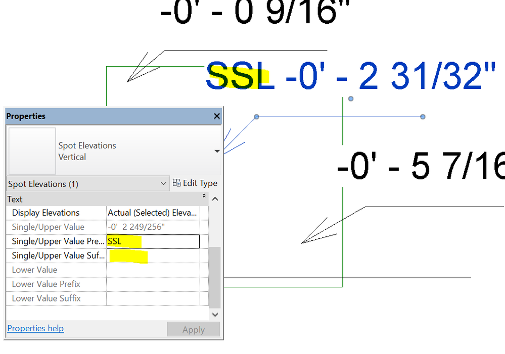

Hello.
I want to indicate ssl and ffl with spot elevation in section. But the options are grey out. And also the family hasn't label, so i cannot edit it..
1 ANTWORT 1
Nachricht 2 von 2
Sahay_R
als Antwort auf: bozandilistan
1)In Properties - add a prefix or a suffix for the value that you want
Go one step further than your  screenshot and click Edit Type
2) That will allow you to edit graphics and create a new spot elevation type
