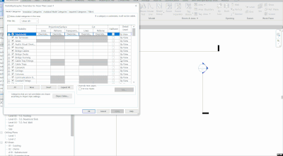

Can someone please tell me what to select in Object Styles to be able to change the lineweight of a section head? I got the 'Section Line' but not the head, and 'Callout Head' doesn't seem to affect as shown below.

@PhilvK
The Line Weight of the Section Head = the Section Mark under Object Styles...right under the Section Line.

RDAOU - When I do it your way the section heads still remain blue.

I can get the section color to change weight and color. I was wondering if the section head and view direction flag could also be changed. Please see below.

OK I get you now...The Blue color you see in the view port is related to the Active Link which is in the Section Head.
Section Head Color in Printouts
  • When you print, IF you uncheck "View Links in Blue" it will print
    1. the actual Color of the LINES following Object Styles
    2. and the Color of the Filled Region following the Solid Fill color used in the Family of the Section Head (this has no object style and color is set in the family)
      • PS: Some users try to work around the solid fill by using a fine horizontal or vertical lines pattern which then forces it to follow Object Styles
  • If you want to disable that BLUE LINK behavior in the Views (ie: see the section Head Red in the view ports) you need to use a View Filter which overrides ALL or Certain Sections (SEE GIF BELOW)

Ah ha! Thank you!
