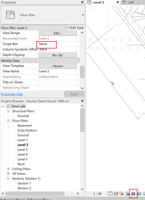

Did you apply the scopebox to the view? Set it too none and then click on the uncropped view. If you still don't see it, go to 3d and check where the scope box. Make sure the scopebox placed in workset that is visible.

Once you working on tower project, scopebox will make sense. It can also control the extent where your gridline and level so user cannot accidently stretch the grid and level line. The reason you cannot rotate is you have the scopebox set on the view. This is why you cannot see it because scope box is where the crop sit. Go to other view that don't have scopebox and then rotate it.

You will come to appreciate scope boxes when you need multiple views sharing the same crop region.  To rotate a scope box, open another non-cropped view with scope boxes turned on, and rotate it in that view.
