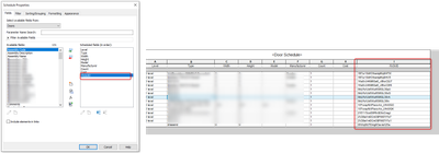

In Revit 2023 and 2024, you can add the IfcGUID to your schedules and then export it to Excel.

Looks like I will be upgrading to 2023, interestingly the ifcGUID parameter is listed as an option to schedule in 2022 but it doesn't return any values. That's unfortunate.
