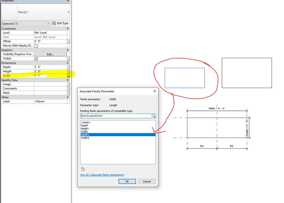

Message 6 of 8
Please see attached.

That is precisely what I show in the example above 😉
