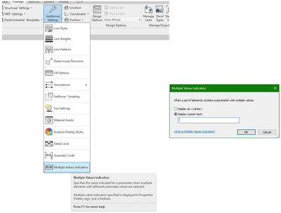

I thought of that, but then "varies" should be displayed.  No?  Maybe OP formatted to omit "varies"?

This?
Message 8 of 12
Message 9 of 12
Mike.FORM
This is why I always keep it as <varies> so that you have some indication. I know some that change this to just blank.

That option not appear in Revit 2021.
