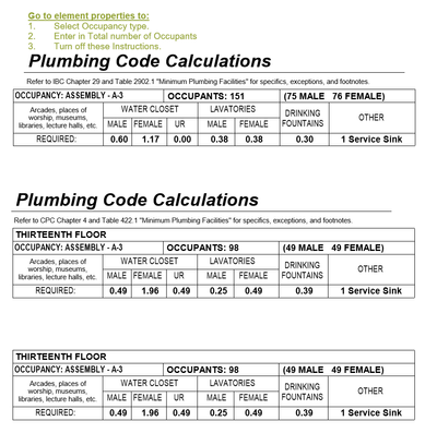

I have a plumbing count family. It is a Generic Annotation family that includes families for all of the occupancy types. They can be selected via a dropdown menu. Each family you place the occupant count in the Instance Parameter and the family does the math involved in figuring the counts.
Screenshot of the family in a project:
Screenshot of the family:
Is there a way to put these parameters into a schedule? Right now the family is doing all the calcs except for totaling the different occupancies together.
My initial thought is that it's not possible because each instance of the family for each occupancy type is using the same parameter. The math is just different in that version of the family. So how would Revit know to discern between 5 instances of the same parameter showing 5 different numbers. There would need to be some unique element in each to be able to filter and sort.

Yeah, each family has the same share parameters but the formulas are different.
I wouldn't need the formulas reported, just the values. So Ideally if we look at my first screenshot, it would be great if I could throw those numbers into a schedule and then have Revit spit out the totals.
I could see the different family types being down the side of schedule and the different parameters being across the top, but not sure if that's possible.

Okay, I've made some progress. I figured out, I don't make these that often so I hadn't checked, I needed to make a Note Block in order to get the Generic Annotation into a schedule.
I still can't get the figures into the schedule. I did set the Occupancy Type families to be shared, so now I can tab and select them in the project and see the figures.
The screenshot shows the families on the left with me tabbed into the shared occupancy type family. On the right is the note block schedule and the properties tab showing the tabbed occupancy family.
What step am I missing to get them into the schedule?

All parameters for entering value must be shared parameters so that they will show in schedule. Add calculated value parameters with formula to schedule directly to replicate calculated labels in the family

Gotcha. Working on a Dynamo script now to grab the data and pull it into a parameter I can use in a schedule.

Ian_H
als Antwort auf: barthbradley
In the Schedule it would have across the top
Occupancy Group - Occupants - Men's WC count - Women's WC count - Urn Count - Lav Count
If I can get it to show those figures then I can have it add them together which is the part of the process the family is not doing.
By making the occupancy family in the plumbing count family shared I can tab into it and select it. The way I took Aaron's comment is that all of the calculated values, the ones I want, need to be manually input into a project parameter. So since I can tab into it and select it I'm going into Dynamo and grabbing it and then selecting the properties I want and am going to send them to a project parameter that I've created.
So at the end of the day the user will:
1. Figure up Occupancy
2. Enter that number into the plumbing count families
3. Run Dynamo Script to grad that data and fill in Plumbing count Schedule to get the totals needed
Nachricht 10 von 10
Ian_H
als Antwort auf: Ian_H
I got my Dynamo script finished and working so now my schedule is looking good
