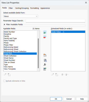

SCALE PARAMETER IS DELETED FROM THE REVIT FILE , I TRIED TO REMAKE THE PARAMTER BUT IT IS NOT READING AUTOMATICLY FROM THE LABEL ASSIGNED IN THE SHEET , CAN YOU HELP TO RESTORE THE ORIGINAL PARAMETER TO THE FILE TO READ IT AUTOMATICLY ONCE AGAIN

I don't understand what you are asking or showing.  Your top screenshot is showing the view Scale label on the Sheet Titleblock circled in red. Your bottom screenshot is showing a list of Project Parameters. One has nothing to do with the other.  The view Scale is a label (with special powers) that is created and placed inside the Titleblock Family.

the label in the title block in showing correctly , but the scale is not showing in the drawing list schedule , the scale parameter is deleted from the entire project , that's why i am showing a screen shot from the project parameters , i tried to recreate the scale parameter inside the project but the label and the new parameter are not linked together any more

the scale parameter isn't linked with title block label any more that's why the drawing schedule not showing the scale in the schedule , can you advise how to solve it

The Scale Parameter is not available for Sheet Lists!
It is available for view Lists as it is View Specific

I don't understand what you are Scheduling. Titleblocks???
First, you can't directly, but maybe you can via Dynamo.
Second - and foremost - if you had Multiple Views of different Scales placed on Sheets, that "Scale" Label would read "as indicated".   Is that what you are after?
