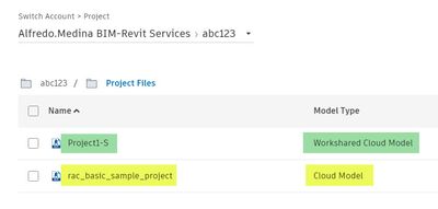

Notice the difference between these two files in a BIM360 project: for the file highlighted in yellow I used "Save as Cloud Model" from a file that does not have worksets. Now that model can be opened and linked by other team members of a BIM360 project, even though is a file without worksets.
When a Revit file is simply "uploaded" to BIM 360 is only available for download from the website. It's not even visible for Open or Link when you are in a BIM360 project.
There are 2 levels of usage for BIM360, one is as a simple file exchange website (BIM 360 Docs), which is free if you are invited to a BIM360 project, or if you have the collection. That level is only for uploading and downloading files, similar to using Dropbox or similar sites. The other level is BIM 360 Design, now called BIM Collaborate Pro, which is not free (it's about $115 a month, or less if you pay it annually), and this is the level that allows you to open Revit models from Revit and save your models to the cloud, and collaborate with consultants, etc.
