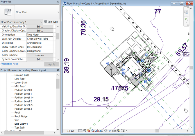

Hello there,
I am trying to rotate an entire model in Revit about 25 degrees to make it align with a terrain site plan. I have tried 'create group' and'create instance' but several elements of the model such as oblique beams and balconies rotate in a wrong way. I have also tried rotating the view but this method is only view specific and when I try to copy paste the view it pastes as normal, not rotated. Is there a simple method to do this?

Nothing seems to work. I have tried most things. So the project is in one file and the site topography is in a separate file. I did manage to change the orientation of true north on the project file but when I try to copy it across to the topography site file it doesn't copy with the true north slanted orientation. I have inserted the two image in this message for your consideration.
I would appreciate if you could guide me.

  1. You set the Site model up (coordinates and true north)
  2. You link the Project Model in
    • Rotate
    • Move and Aline to position
    • Then (Ribbon/Manage/Coordinate) you Publish coordinates  to link and save to have a shared site
You can do it the other way round too if you started with setting out the building model

I would go against rotating building to fit the site plan. It should be the other way around. First you set your project to true north
Next select rotate to true north
You should be able to toggle between true north and project north.
If you don't want to mess this up, you can setup scopebox. Rotate the scopebox by 25 degree to reflect where you want to rotate the view. Then set the view to scope box and it will automatically rotate your plan.

It works perfectly, thank you for this advice.
