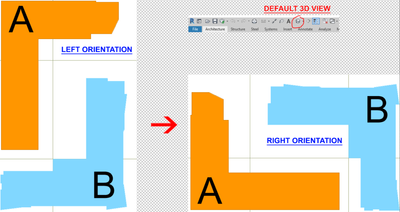

I was given a Revit file that has 2 different grid lines orientation.  See attached image.
The one on the left is for the A2 series (overall floor plan) "portrait orientation" and the one on the right is for the A6 series (overall RCP) "landscape orientation"
You can tell by the 0,0 insertion point
I don't understand why it's setup this way because normally these 2 series have the same exact set of grid lines and orientation.
Anyway, I assume the A6 series views got rotated because when I click on the default 3d view button at the top, it matches the grid lines orientation on the LEFT.
My question is:
How can I make the default 3d view of the 3d model to match the grid lines orientation on the RIGHT (BLUE COLOR)?
I want to export the revit model as DWG file so that the orientation matches the one on the right.

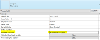

The image on the right is likely rotated on the sheet using the property shown below. The proper orientation of the grids for the model is the Red view on the left.
If you rotate the 3D view to have West as the south, this should match the Blue image on the right.

Because all of the RCPs are based on the orientation on the right.  Just want to make sure when I export the entire 3d model to DWG file (some of our subs don't have revit), it's going to match the orientation on the RIGHT per the attached PDF file because all of my subs drawing are set to match the orientation on the RIGHT.  They don't want to change the orientation on their ends.
Right now, when I click on the default 3d view button, the entire model matches the orientation on the LEFT.  I'm just curious if there's an easy method to ensure when I export the entire model out, it's going to match the orientation on the RIGHT, not LEFT anymore.

Sorry, I wasn't very clear in my previous post.  Let me rephrase the whole situation.
See attached files.  Hopefully you will understand my question.
01 file
This shows how the overall 3d model looks like now when I click on the "default 3d view" button (circled in RED) at the top.  As you can see, the orientation is based on sheet A2.01 thru A2.11
02 file
This shows how the floor plans look like on sheet A2.01.  As you can see, this orientation matches the default 3d view.
03 file
This shows how the roof plan looks like on sheet A2.67.  As you can see, this orientation is rotated 90 degrees now.
04 file
Is there a way when I click on the "default 3d view" button at the top, instead of looking like the one on the LEFT, can I get it to look like the orientation on the RIGHT instead.
This is referring to the entire 3d model, NOT just certain view on certain sheets.
Because the MEPS are using the orientation on the RIGHT now, I want to make sure it's an easy export whenever I export the entire 3d model.

OK, this is what I just did.
In the default 3d view, I clicked on the project base point and changed the angle to true north to -90 degree
Then File > Export > DWG files (and choose share coordinate for the export setting)
Then this is what I got.  See attached.
The rotation is correct but the entire building doesn't align with the grid lines in the A6 series.  Why?

This is what's happening:
Originally, when I click on the default 3d view, and export the model as it's.  The orientation looks like the one on the LEFT.
When I export any of the A2 series sheet file, it matches with the orientation on the LEFT.
Because my subs want it to look like the one on the RIGHT, so I followed your advice by changing the project base point, and with the shared coordinate export setting, the rotation is correct and this orientation is what the subs want.
BUT, when I extract the A6 series sheet files, the RCP and grid lines do NOT match this new orientation on the RIGHT.  My snapshot I attached earlier clearly shows that.
The question is why they didn't match in this relationship?  But the other orientation matches automatically without any tweaking.
Do I just need to manually align the model to match the grid lines after I export the model?  I don't mind to do that, but if there's a way I can eliminate this step, that would be great.  Thanks.
