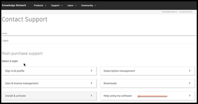

Here are the steps to Contact Support:
  1. Go to https://autodesk.com/gethelp and sign into your account limwendy_0-1667387406719.png
  2. Click the Post-purchase support box.
  3. Select Help using my software
    Note: For problems launching the product, or with the installation, activation, or licensing use the Install & Activate option.
  4. Select your product from the drop-down menu, add a detailed description of your issue, then click the See Options button.
  5. You'll now see your subscription contact options. Click Schedule a Call to make an appointment to speak with an Autodesk technical support specialist. Click Create a case to send your question via email.
Finally, the Self-service options will indicate a snapshot of the most recent solutions from the  Knowledge Network, specific to the product selected.
You will receive a notification based on the company email you registered. Reply to the email and share as many details as you can. The support team will try to reproduce the issues for you and provide possible workarounds.
