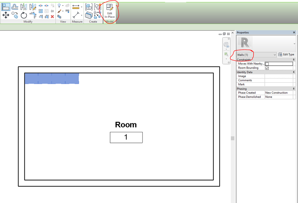

Is there any other way to create a room tag that calculates room areas minus the area of built in casework without using room separation lines? That's one step that the team would like to omit.
I can create a Net Area label for Room Tags that will calculate Area minus Casework once I have input the area into its parameters. But that would mean calculating the area of casework - something else for team members to balk about.
Can some kind of intelligence be added to Casework so that it is automatically removed from the room area or at the very least it calculates its own area?

I draw casework with a wall type. They get excluded from the room.

Create model in-place walls and insert casework in them.

I didn't get it right off the bat, because I missed the "Wall" category for the in-place, but it works like a charm. I guess as far as scheduling casework goes, you would need to start from a "Multi-Category", or else it won't pick up the cabinets in the in-place walls.

Make casework families "shared" and they will be picked up by Casework schedule.

Multicategory schedule - picks up the Wall/Casework, not regular Casework
Sharing the Casework families in the In Placed Wall undoes the area reduction

The host family is not shared to allow Room detection.  The nested family is shared for tagging and scheduling.
