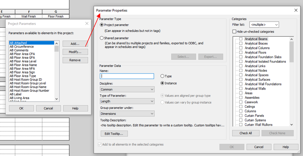

There are already Fields for Floor and Ceiling...and for Walls
If you want to create Fields for each Wall then:
You have to create Shared Parameter (text parameters) for East,West, North and South and you'll be able to see them in Schedules and Tags.

following the tip of @constantin.stroescu , then you can fill those parameters with API routine. Not easy though.

Look into Roombook extension.
