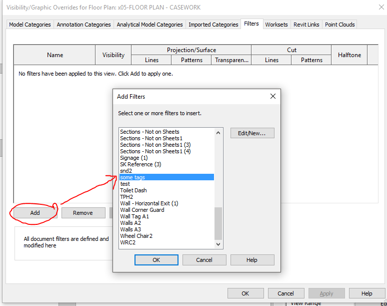

- Right click on the Family Type in the Family browser and Select All Instances in Entire Project
- Click on the Save button on the Ribbon:
- VG, add the Filter, and hide or override its visibility/graphic
